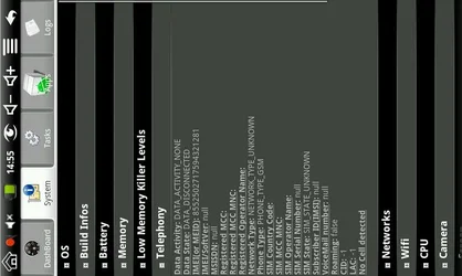

I pull up Android System Info utility and go to Telephony See Screen Cap
There is an IMEI, but it does NOT match the IMEI on my Qualcomm unit
Very Bad Sign
So, I power down and Pop open my case and inspect the Circuit board. (DO NOT ATTEMPT UNLESS YOU KNOW HOW! - Not Difficult but can see potential for breaking screen or switch connectors)
Aha, My unit has the solder points for a SIM holder. The Circuitry must have the IMEI baked in.
Thus, my device is 3G ready waiting for the SIM on the Board
The file indicates USB Modem potential, but NOT with this Qualcomm (at this point)
