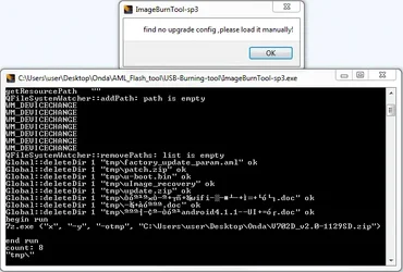

I try it and got the same message, maybe i do something wrong ?
this is the message..

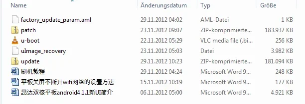

Here a photo of the files inside the .zip folder and really i can't find a conf. file.

Hi, sorry i should of spotted the file list, your firmware is not set to be flashed using usb, the usb program is looking for the "config_progress" file which you don't have. Format a sdcard to FAT32 then copy the following files to it -
factory_update_param.aml
patch.zip
u-boot
uImage_recovery
update.zip
Now make sure tablet is charged to at least 60% then boot to recovery, the white droid will show for about 30 seconds then go and reappear then the green droid will show along with the progress bar. It will restart when done.

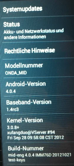

here again some Photos

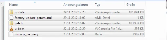

1) This are the data of the sdcard
2) this is the information from my Onda
3) after factory data reset
after that still the same datas on the Onda.
