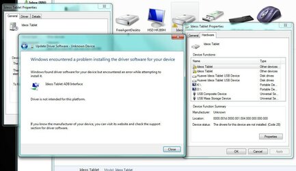

I could use a bit of help getting adb runing on the S7. I've downloaded and installed the driver from Huawei. I have my tablet rooted with z4root. When I plug the tablet in, It shows USB debugging connected in the status. When I first plug it in an "installing device driver" window comes up, which changes to "ideos tablet failed". In the control panel there is a yellow exclamation mark by the "ideos tablet ADB interface" and by the "Ideos tablet other devices" Under properties it says "REinstall driver code 18" When I try to reinstall it says it is up to date and won't install. When I run "adb devices" on the computer it shows daemon not running, then it says daemon started successfully, then no devices connected; I guess that is not surprising I've used the mass storage feature and that works.
I'm thinking that maybe I don't have the right USB driver. I'm on Win 7 64 bit.

Thanks for the responses! After deleting the driver, then reinstalling, I'm getting the message below. Apparently I've got hold of the wrong version, or there is no version for Windows 7 home premium (64 bit). (click to embiggen)
Thanks, that appears to be the same packate, but I tried it anyway, and pointing to the WIn7-AMD64 folder, still getting.
"This device is not configured correctly. (Code 1)
Driver is not intended for this platform.
To find a driver for this device, click Update Driver."
