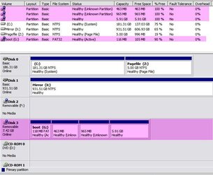

How do you transfer MUSIC & VIDEO to the SD card (CM7), over WiFI (samba)? I plug my SD card (CM7) into my WinXP and it only shows one accessible partition (G:/) with the following files:

Here is a pic of the XP Disk Manager. Does this look right? (pink highlight CM7 partitions)
Yes, you can use Samba or Drop Box. A bootable disk is partioned in a way that your PC can no longer read it (or actaully only sees a small partition).
