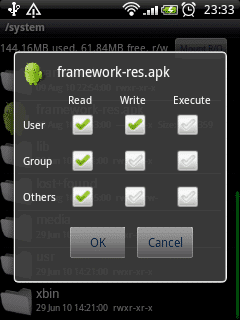

- Change the file permissions to rw-r--r--. Graphically it would look something like this:
You may also have the option to set the Owner and the Group. With the file manager I use, Super Manager, I have this option when setting permissions. If you do have this option, change both Owner and Group to 0. This sets both to root. - Move framework-res.apk from \system to \system\framework, letting it overwrite the original. You will have been successful if the tablet does not instantly reboot upon copying.
