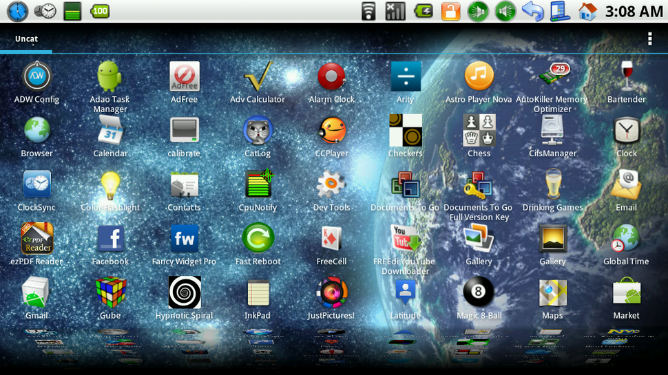

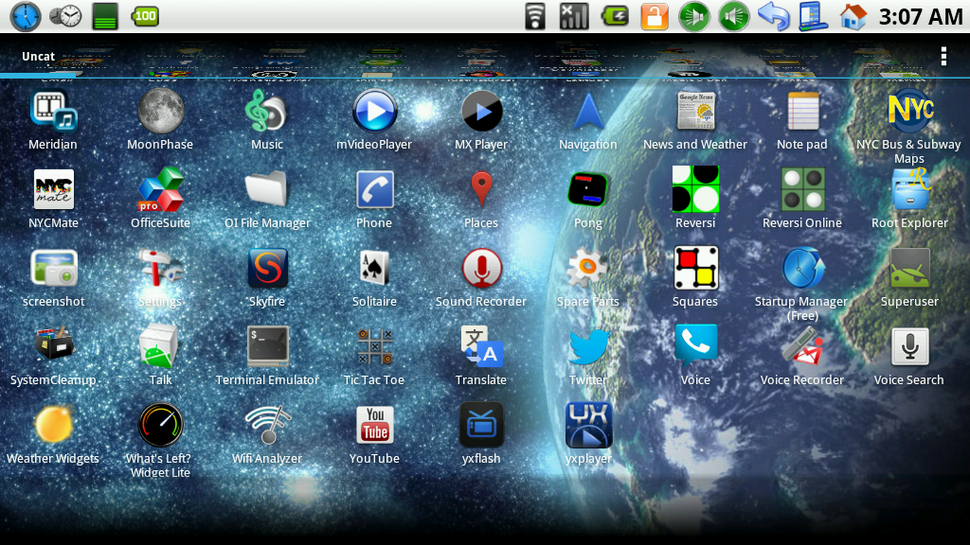

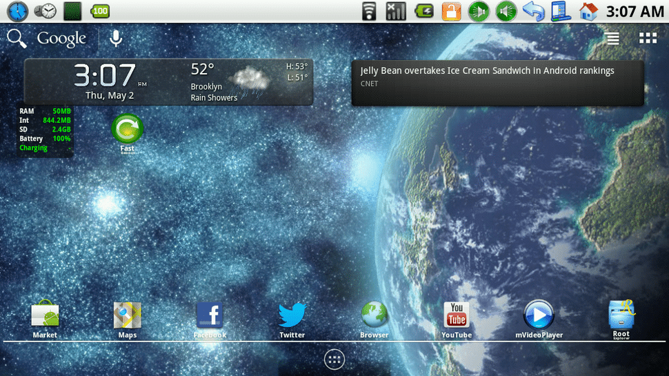

I'm still tweaking my tablet, but after installing ADWex launcher and a few apps, and changing the wallpaper, this is how my tablet looks:

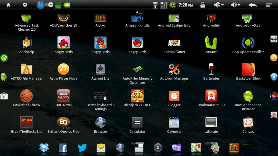

I've actually since flashed back to the 0603 Froyo ROM.... If you want that version on your tablet, you still need to flash the 0117 Éclair ROM first, since the 0603 Froyo ROM needs to be flashed via a (fat32 formatted) sdcard, but the ZT_Bx.boot file of the 0117 ROM needs to be flashed on the tablet first via the burntool to get sdcard flashing capability.... With certain tweaks, there are more apps available on the Google Market/Play Store on Froyo than on Éclair... http://www.mediafire.com/file/tk98w8cmgqr287j/0603ZT180v1ZenithinkFTPfilesAndroid.zip
Some screenshots of Froyo on my tablet using (VTL Launcher):
