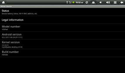

EDIT:
This is incorrect, as I lost the version seen above. I ended up using the entire Flytouch4/YOSPAD firmware and it is now:
... which is even better, as it is almost completely what it had before (except for the initial splash screen...)
I still need to ensure factory reset capability, etc., but for now it WORKS!!!
