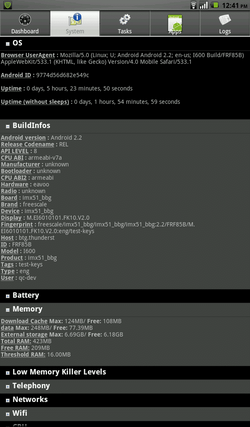

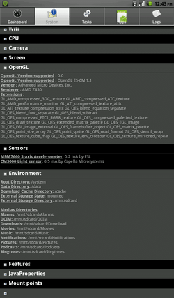

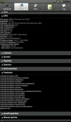

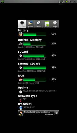

Someone please run ASI and give me a few screenshots. Kernel build strings, anything. We know nothing about this tablet right now.
Here are some shots I took today.
