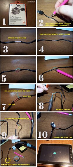

Thank you so much madin.....here is the ipad cable mod follow up....;) it would be better if you can, to use heat shrink instead of tape.

What I did:
1) I used a common USB extension cable, preferred a short one.
2) Carefully I opened the cable jacket with sharp knife.
3) I saw four wires coloured red, black, green and white. No wires where hurted:)
4) The red and black one are the powersupply of the USB connection.
5) The other two, one is white and the other green, (colours may vary) I cut through.
6) The white wire of the ipad recharger side I electrical insulate with tape.
7) The green wire of the ipad recharger side I electrical insulate with tape.
8) The white and green wire to the KINDPAD I shortcut.
9) The shortcutted wires I electrical insulated with tape
10) If the red and/or black wire got hurted during step 2, electrical insulate them with tape too
11) I summurized all electrical wires and put tape around to fix them again
Now the IPAD wall recharger works since a couple of weeks fine with my KINDPAD.
By the way the charging cable comes with the wall charger of the IPAD works well with my kindpad as a charging cable and USB connection :)

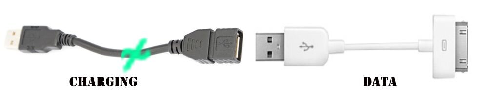

Yeah, Ill try the car charger next and post my findings. The really cool thing about this mod is, I am now able to charge the kinpad via the usb port on my PC. Madin cut a usb "extender" cable because he didnt want to cut the ipad cable so he can also use it for data transfer and charging. I cut the ipad cable and Im using it strictly for charging. Im using a longer ipad cable for usb data transfer.;)
Car charger works great too................LOL!! Hey toby, can you list the voltages off of your home charger? I threw mine away. People need to know the voltages if they are going to attempt this cable mod so they can buy the correct charger.

Read post #534 It will only work for data if you cut a usb "extender cable" loop is on the 30 pin side. combined cables = charging / single cable = data
