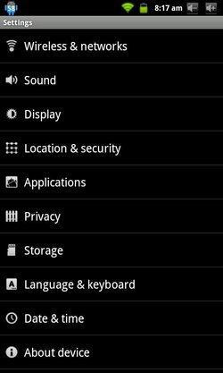

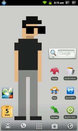

The difference is really noticeable I like the screen much better now. Before the android man (top left) was all shortened and fat because of the weird default 7022 is set too. For a comparison since I did not take screen shots you can go to your settings menu then look at my screen shot and see how many items show up for you. I will try to get comparison screenshots of 180 vs 190 vs 200 (stock) in a little bit.

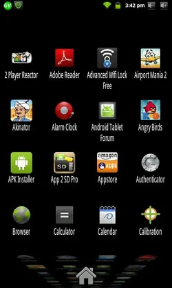

Comparisons:
200 (DEFAULT)
180 (NEW)
Best if comparing images on the tablet so changes can be seen much much easier.
