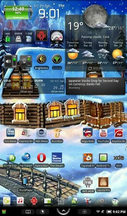

My Christmas present to you guys. Its not much, but the least I could do for all your help. Yeah - its just a screenshot of my NC - sorry I didn't have time to wrap it :)

Wow, have you been busy!
But what's this "you guys" stuff??? YOU answered a question...you helped a newbie. Now you're one of us. :p
Have a great XMAS, and thanks for the screenshot!
-Matt

@JackOnan
Nice pic. What version weather channel app do you have?
