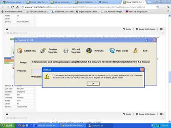

hi please help,
i have my 8inch chinese tablet bricked, i kinda played around with the build.prop thing and now its stuck on bootloop. my tablet is the same with momo8A but its not, it's cdrking fastpad 8 inches FP-002-xon, but since it looks the same inside and out with the momo8 like in the picture armsagitta posted i tried his instructions... but no success... i also tried killerkinks but all i get is the .img files not
available like iin the picture$untitled.webp i dont know what to do now... please help

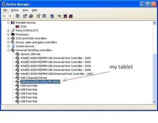

i have installed the driver from the instruction and tool from livesuit from momo website and this is whats installed in the pc
is there something i did wrong in installation? and also will the momo8a firmware work on my tablet? considering they have the same architecture inside?

If you have the native firmware for your Fastpad tablet, use it. I can't tell for sure if the MOMO8A firmware is compatible with yours.
First, make sure to extract the firmware .img file to a folder like C:\temp or whatever you like.
Then, follow the right procedure to flash the firmware: by pressing and holding +, at the same time connecting the usb cable. Then, while holding + button, immediately short-press Power button up to 10 times until you hear a sound and a pop up window with instructions. Release + button now.
Good luck.
When you think you have bricked your mono. You need to do a hard reset.this involves pressing the power key and reset at the same time. You will know when this has worked because when you plug in the mains or the USB the charging screen will be displayed. Live suite will not work unless the tablet is off and this is the best way to be sure. Charging screen means its off.Once you have achieved this and it can take quite a few attempts. Run live suite and your tablet should be back.One the best points about player tablets is they are virtually unbrickable.
