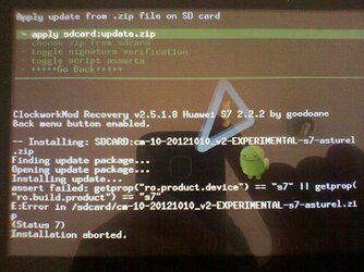

I selected option to WIPE on recovery and later selected update...
And reached at this point with the "cm-10-20121010_v2-EXPERIMENTAL-s7-asturel.zip":
But show this error.
My devise is not the S7 Slim 201u, my device is the S7 Slim 202u ¬¬
Someone know the difference? I'm using firmware of 201u and working all right.

it works since the first release, if u install it on a different device (different than 201u/w) dont be suprised if something doesnt work.
anyway u can try to replace /system/lib/hw/sensors.default.so with your device's one.
