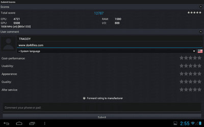

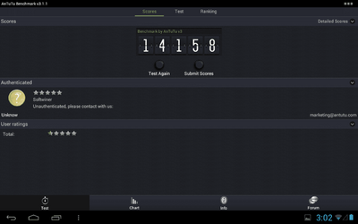

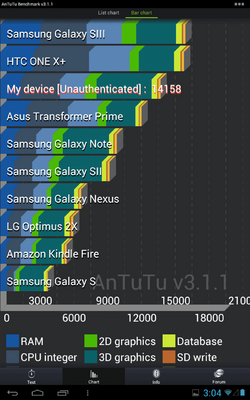

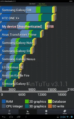

Initial ROM 12.7k
Performance Mode
Compare

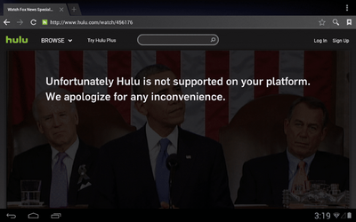

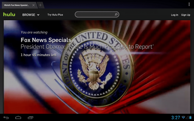

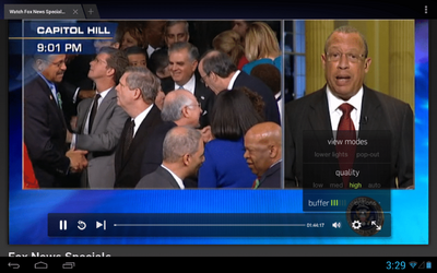

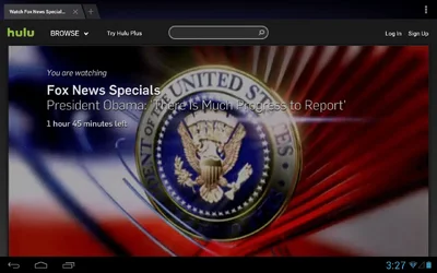

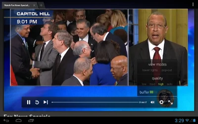

Stock Flash & ROM with Hulu provides no hulu in browser.
And fixed, I'm also in Canada.

antutu cpu master for the clock and govener, I would not clock the unit at 1200 then gov to performance which locks it at 1200 always this would be a mistake and should only be engaged for gaming or hardcore multi tasking as the CPU will drain the battery in no time.
