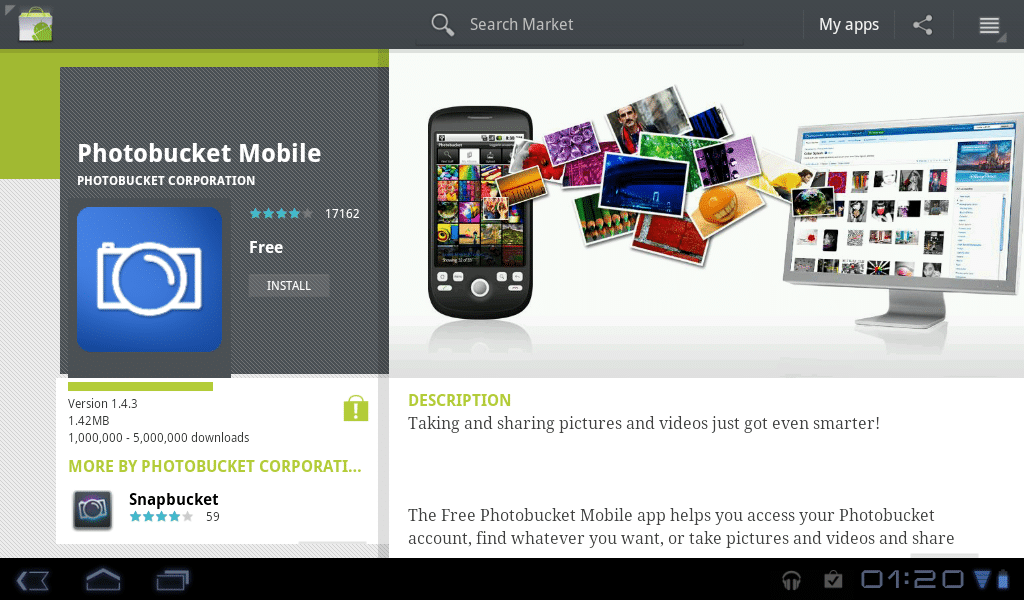

With the stock Market still being funky, what options do i have?
The system can still side load apps, so any APKs you can grab can be installed with adb. Additionally, because of this,you can install other 3rd party Markets such as Slide and Amazon, which will let you install more apps.
