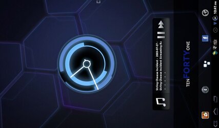

Heres a screen
Looks tight, especially the bottom bar and hc soft buttons.
Yea having everything on the bottom makes it more user friendly. There is some black on black text in some menu items, but it's not too bad.
