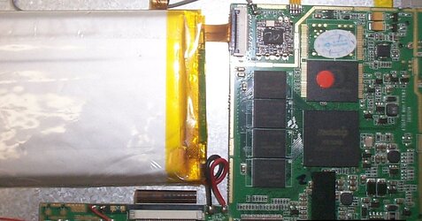

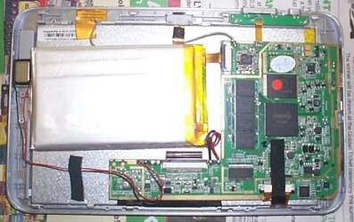

I have tried google, but after wadeing through page after page all I can find is onw site that offers "an excat replacement" battery. But, while the votage and apperence is the same as the orginal (see photos) the amps are not. The "replacement" puts out 2700mA while accourding to the Sanei N78 feature page the battery should put out 3500mA. Does 800mA make that much a difference?
Second, how do I install it?:confused:
The battery seems to be glued to a metal panel, and I am worried that if I pull on it too hard, or use heat/slovent on the glue the screen or some other part of the tablet will become ruin.
And that would spell the end of this tablet.
Any help would be appreated.
The "replacement" puts out 2700mA while according to the Sanei N78 feature page the battery should put out 3500mA.
There's no danger of damaging anything with a lower mA rated battery. The only problem is it would only last roughly ¾ as long between charges. (2700/3500=0.77 or 77% the capacity of the original battery.)
Second, how do I install it?:confused: The battery seems to be glued to a metal panel, and I am worried that if I pull on it too hard, or use heat/slovent on the glue the screen or some other part of the tablet will become ruin.
That's trickier, no way to tell what they used to paste it down. As you already know, proceed carefully whatever you try. It doesn't appear to be attached to the circuit board, I'd try prying first. Good luck!
Thanks for the advice, but, I just wonder why when I do see a "replacement" battery for this Tablet the output is always lower then what the company states the battery should be.
I never have seen a replacement battery whos output equals what the company say what the battery output is given as.

Before I deleated it, this message was going to be if could use a battery with a bigger mA then what in the tablet now.
But, after I was able to remove tha battery form the tablet (using a dinner knive!) I was shocked to see that instead of the factory stated 3500mA battey I had a 2700mA battery.
So, it seems that Sensis lies about what kind of battery thay use. :mad:
But, it does answer the question of why after stateing the tablet will work for 4 hours using Wi-Fi, it lost power at the 1 hour mark.
I am going to try to see if I can get a 3500mA battery (in the right physical size) or if I am stuck going back to a 2700mA battery.
However, this episode does make me wonder how many other of the "cheap" tablet makers do the same?
The new battery must be a 3.7V. The higher the [FONT=arial,helvetica][SIZE=-1]mAh, the longer it will last per charge, so get a larger one if possible. Just be sure it will fit into the case of your tablet.[/SIZE][/FONT]
