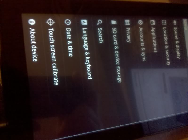

Is there nothing I can do without an SD card? I don't see a system update option, anywhere.
Go to SETTINGS then System update. Believe its second from the bottom. It WILL update. But if you go back again and again it will install the same update. As to having a MicroSD card. Yeah you should have that or at the very least use a Thumb drive with the included Dongle.

Still not seeing it. This is the bottom end of my settings menu:
I'm going to grab a MicroSD now. Maybe that will help?
