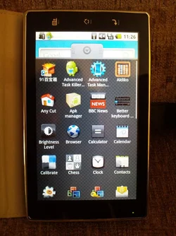

I have just bought this model and the box says it's from huashiguang.com. It' seems a bit more stable than the 7" rockchip model and is more heavy. It comes with a nice wallet that is actually screwed to the Apad. It has a nice chrome sides but the rest is black. It has a micro usb port, a normal USB port, an earphone port, a power port and a HDMI port. The on/off switch is now on the side. The speaker is still on the back but you can actually hear stuff on this model.
When you connect to PC via USB and mount the USB, the files you copy to it go into a directory called /nand.
The storage space shown in settings is misleading as it actually has 3GB of free space which you can see when you connect it to the PC.
Not sure how you can tell what memory it has. Apparently it's 256MB but I can't see that anywhere.
In the "about device" is says it is model X5A running firmware 2.1 update 1. Kernel version 2.6.29. Build number X5A 1.0
I did try factory reset on it and it just powers off the device. I also reset via tiny hole on front and again it just powers off. I wanted to clear the google market account and this is what most people say to do. But in my case it doesn't.
Oh and one other thing. It doesn't have a gravity sensor even though most people selling it say it does.
I do have one problem with it which I hope someone might be able to help with. I stupidly connected the HDMI to my laptop and now any video or utube i try to play only outputs the sound and no video. I get a lttle white triangle in top left corner for a second at the start of the video. Any help would be greatly appreciated.
Overall I think it's a very smart Apad even without G-sensor.
Here is a picture.
