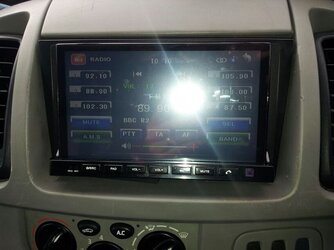

ref question 7 yes my unit shoes frequency (102.5) & station name (bbc radio 2)

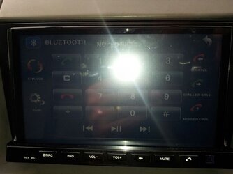

About phone book, can you make me a favour, please? Please, go into Bluetooh display of ES777 and tell me which buttons are on screen (if you can take a photo, much better).
Thanlk you a lot.
Sorry for the poor picture quality, you should be able to see despite the flash.
Mark :cool:

Thank you a lot.
If you pair your phone with device bluetooth, the buttons for bluetooth screen are the same or there is another new button?
