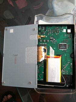

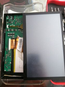

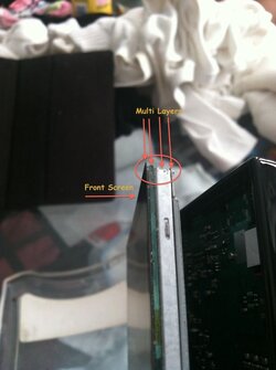

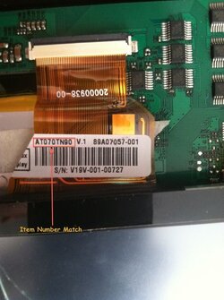

View attachment 7176View attachment 7182View attachment 7174View attachment 7180View attachment 7181
Item description-FULL LCD Screen Display + Touch Digitizer AT070TN90 AT070TN92 AT070TN94 6mm
The 1st pics is the eBay item and the last pic is the barcode item number and serial so it seems to be the right screen but when you said you had to replace it yourself did you mean the screen or the entire tablet itself? And if it was the screen is there anything I should know before I install it like the removal or transfer of anything from the old screen to the new. Because in the 1st pic it looks like that would be the back if I where to follow the ribbon placement, to the naked eye that ebay item pic looks like the front screen minus the fact that it has a silver bezel instead of the black. Thanks again.
