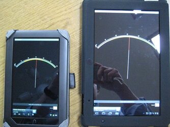

I was able to install "WiFi Analyzer" on my Nook Color, put it side-by-side with the A500 and was surprised by the results. In most cases the A500 was either slightly below or equal to the Nook's sensitivity level, in a few spots the A500 actually got better signal than the Nook.
What I did notice however was the Nook was better in picking up "fringe" i.e. very weak/distant networks as compared to the A500. At one point the Nook showed as many as 6 access points from inside my house where the A500 never showed more than 3 AP's at any time. Keep in mind- those distant AP were so weak that they were unusable and kept disappearing and reappearing from the Nook's Network scan.
Photo below shows the Nook Color on the left and the A500 on the right- both sampling the same access point in my house... pretty similar readings!
