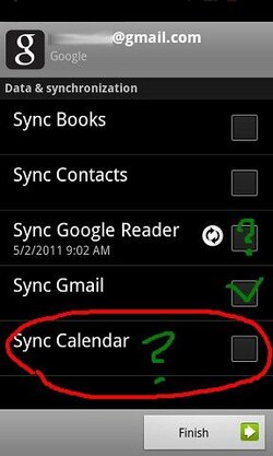

Hello,
Does anyone know how to install the synchronization of google calendar and google documents?
I got perament root device (i use this tutorial: xda-developers - View Single Post - [Q] Root Creative ZiiO 7" Android 2.2).
I install market and google apps like in 1 post and in Sync Settings i see only: GMAIL.
Try to create new account doesnt work...
Thanks,
Pawe&#322;
ps. sorry for me english :)
