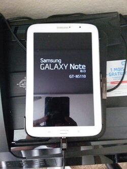

Only thing that is happening to the tablet right now is that it's plugged in and the screen that the screen that is shown here is flashing like a darn strobe light but it never comes on and when it finally does, you have the dead robot on it's back

Yes I've done that , but the only thing it's says is "downloading " "do not turn off target" ..and of course has the little Android man there.
"Downloading. Do not turn off target." means you are in download mode. Now connect the tablet to the PC and you should be able to flash the ROM through Odin.
If Odin doesn't see the tablet, make sure the drivers are installed, you're using the original cable, and are not using a hub. If after all that you still can't connect the tablet, then you'll have to ask Samsung for help. Since I don't have this tablet I can't go much further.
