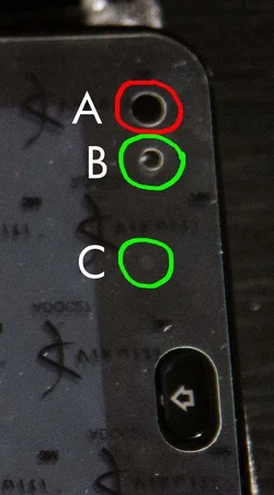

The main shape and the Home button hole are correct, but holes for camera and ambient light sensor are wrong:
Does someone know if moving from hw revision HD104 to HD105 Synrgic changed the camera/light sensor position ???

EDIT: I received the new screen protector and now it's correct. I think this is the only screen protector available for W7
