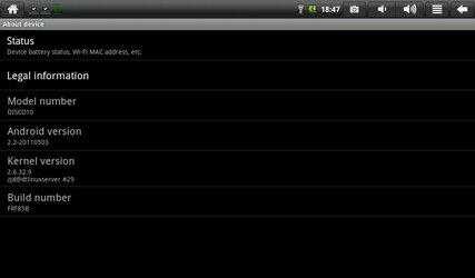

Hello Chandos
I have just tried this update:
20110521 (CUSTOM ROM: Tim: Release 4e. Based off the 20110503 firmware)
Link: http://public.timduru.org/Android/Fl...0601_Tim4e.zip
Tested by: Chandos
It sees to have been a success as the start screen and apps have changed, however the system is showing this information.
Can you or someone else here advise if it has been a true update, partial or am I missing something. I followed the simple instructions and performed the update via a 4gig SD.

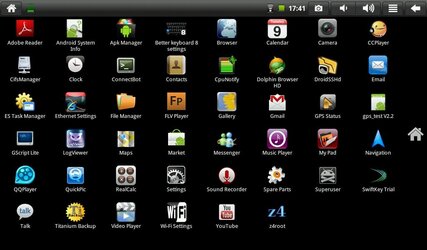

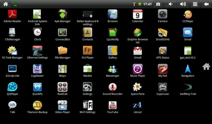

Hello Chandos
Tested by: Chandos
Hi there,
My tablet came with the settings you are showing, with the exception that my kernel version is #47.

Hi Dwane, Sorry to say I have no experience with 3G adapters at this point. Screen shot shows apps after new Rom loaded.
Except for the following:
Adobe Reader
Android System Info
FLV Player
Titanium Backup
Z4 Root.
Hope this is of some help. As for the 3G question I can only sugggest more searching may dig up an answer for you.
