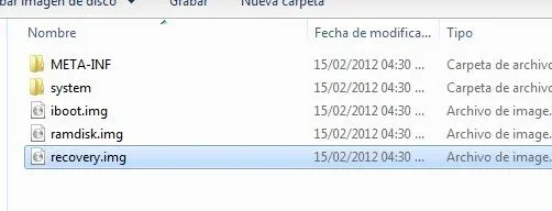

Just a couple minutes I try to install this beta firmware with my SD 2Gb but nothing, it doesnt works. (Firmware file is bad)
I just copy all the files of the ZIP folder (META INF, system, iboot, eamsidk, recovery), I attach one image of the files
Am I doing something worng?

If you want to install the Factory default firmware, you would place all 3 files in the root directory of an SD card.
However - the CWM file has the same name (griffin.ifw) as the Factory firmware file - they cannot be in that folder at the same time. You might have mixed the CWM griffin with the le pan firmware one, maybe.
The 2 GB Sandisk card that ships with the Le Pan tablets is excellent, and what I use for firmware, backups, Beta installs.
I purchased an 8 GB Sandisk card yesterday, and tried to see if it would load CWM from it too - and it did, no problem.
Maybe wipe out those files from your card, all three from the root directory, then rewrite them there, try to load them.
