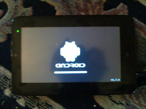

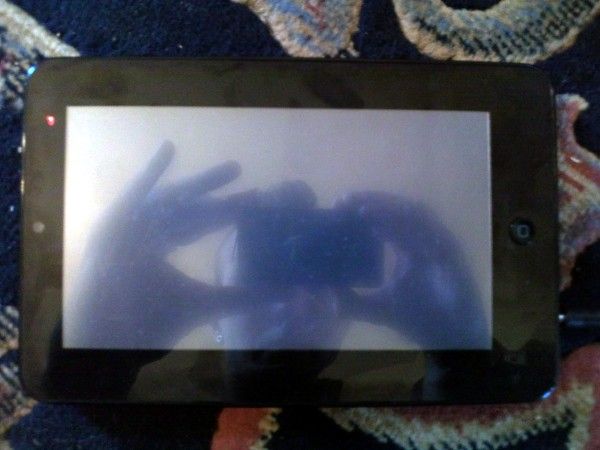

Can I get the thing to boot back up? Can I hell!
At first, pressing the power button would simply turn on the green power light, but nothing else would happen. I pressed and held the power button for 5 seconds to do a hard shutdown (as explained in the manual) before turning it back on.
For a little while, screen would switch on, the device would quickly vibrate and then it would display the android logo. The progress bar at the bottom of the screen would scroll through once and stick with the indicator at the right hand side of the screen; this was as far as the boot up process would go.
It didn't take long (4 or 5 restarts) before the device stopped doing that; now I am back to where I was at the start. Can anyone tell me how I might be able to sort this out? I don't want to have a $100 device for switching on a single LED.
HELP???
(EDIT : It is switching on again now, but it still won't go past the android logo)

I have noticed an odd pattern in the device's behavior : If I plug in the charger and turn it on immediately, the ePad vibrates, the screen comes on, the android logo appears & the progress bar scrolls through once before the tablet freezes. Otherwise, I only get the green LED to show that I have done anything!
(EDIT : I have fully charged the battery, so I know that isn't the issue - once it has switched on, it stays on when I unplug it)
I have really been around the houses with trying to fix this thing, having flashed the device with 4 different firmware iterations today alone (returning to the original version in the end, just so that I can send it back if I need to).
Each time I have flashed the thing, it has told me that all of the updates have been applied successfully, then the progress bar appears and the device freezes.
Right now, I have it turned on (frozen on the splash screen) and unplugged so that I can try running down the battery. Maybe if I can exhaust the charge in the battery then the device might forget that I ever put it into hibernation ... it is a desperate move, but it is the last thing that I can think of doing before paying to ship it back to china!
It worked ... Kinda ...
All I had to do was COMPLETELY drain the battery and now it is getting much further into the boot up process.
The scrollbar is still moving, but still no sign of my desktop after a few minutes of waiting.
