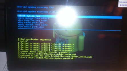

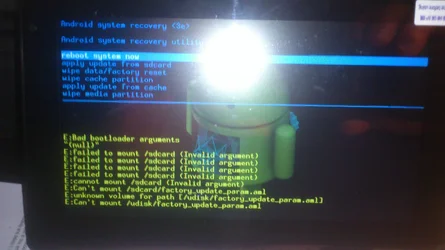

Hi iiDiabolusZz My problem persist... I cannot update from your previous guide of 1.5.5 to v2.0. I put in sdcard update.zip - patch.zip - factory_update_param.aml and after a few second with the white android appears the green android 2 second and then.... $DSC_0015.JPG
I try a lot of times but dont work. What can i do?
Thx
EDIT The problem has been resolved. Sorry. The sd was bad. I change it and all works properly. Thx for your job and help!

I tried what you said, and it worked at some point. It is having an error after the update same on the photo above me, though the difference is that mine says installing patch aborted and media partition failed something like that. and when I rebooted it, it went to factory default without the chinese apps. I wish to install those apps as what you have said, it contains important files. Is there anything I can do more? or should i just proceed to rooting? Or could you just teach me to update using the old way to reflash and install the chinese apps? without using the .aml file , i think v712s are having problem with this process.
mine is ICS 4.0.3 BB 1.5.5
