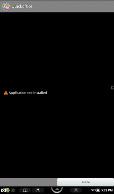

No error, "application not installed" upon installing.
Ok xaueious, finally installed QuickOffice HD
Here is the story and hopefully will help all of us Nook Color owners:
-I had forgot the Nook Color has a pre-installed version of QuickOffice Viewer and I just read on somewhere, you must uninstall any previous version of QuickOffice before installing a new one. To uninstall a pre-installed/root app, you need to get a root uninstaller app to do such
-Go to the market and get "Uninstaller for Root"
-Open and scroll down to "QuickOffice Viewer"
-Press "Grant root", SU will ask for permission
-After root access, press uninstall
-Once uninstalled, us NC owners are free to install QuickOffice HD or any other QuickOffice version you wish
