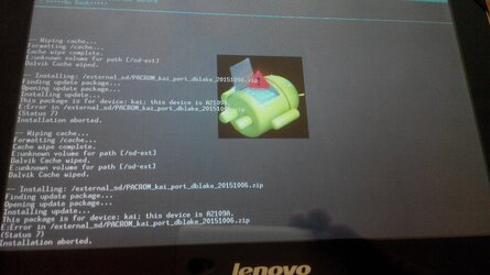

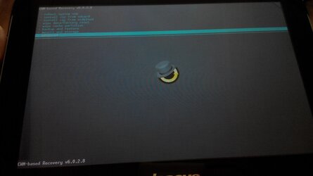

I can't install PAC ROM. I've already flash recovery. (CWM-based recovery v6.0.2.8) see in the picture
1. I reboot to recovery (see in the picture)
2. I go to the wipe cache partition and YES - Wipe Cache
3. I go to advanced and go to wipe davlik cache YES- wipe davlik cache (E:unknow volume for path [/sd-ext]) Davlik cache wiped.
4. I go to install zip from SD card
5. choose zip from external sdcard
6. choose PACROM_kai_port_dblake_20151006.zip - click YES - PACROM_kai_port_dblake_20151006.zip
Message:
This package is for device: kai; this is A2109A
E: Error in /external_sd/PACROM_kai_port_dblake_20151006.zip
(Status 7)
Installation aborted
What can I do, to install this rom for my Lenovo A2019!

You need another recovery, a newer one and JB bootloader. Please find details below.
P.S. Read the thread carefully, everything is described here.
Just download JBBootloader from that thread Useful Files, From Drivers To Modded ROMs | Android Tablet Forum and flash it from the custom recovery you use. Then you are ready to flash the latest CWM 6.0.5.1 from this thread (I used rashr from play store for this purpose). And after that you can flash the recent build of CM11 using new recovery. Good luck!
