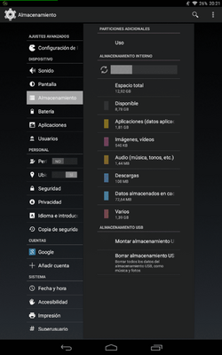

It's the first customized ROM I've ever tried and It's great!, but I also have the problem with the external sdcard. It doesn't recognizes it. And I flashed the ROM from the external sd!!
I flashed with the CMW on the other post, Instaled the rom, instaled the fix (just in case... ), installed the open_gapps-arm-4.4-mini-20151204 to have the play store and tried with different file explorers.... It just desn't recognize the card.
What can I do? @DBlake ,@PJBrs
