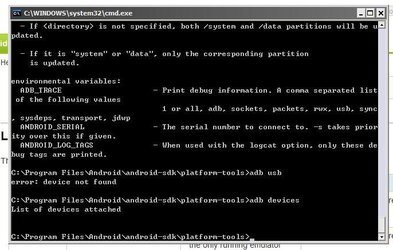

Hi kk, i'm a newbie, i hv a problem...
i even can't connect the p76ti via adb, (i tried both the B4a rom and original rom), i've checked the USB debug "clicked", driver installed...
maybe it's such a stupid questions, but if u hv time, plz let me know how to get dmesg...thanks
