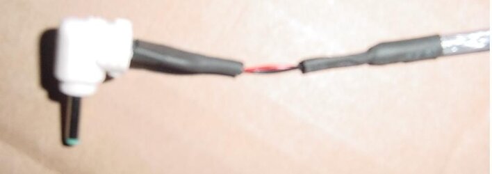

I haven't been able to find a tip to fit the S7 power jack yet, but Radio Shack has "Adaptaplugs" that have two pins you can solder wires to.
Success.
After cutting off the unwanted end of a spare USB printer cable, leaving the other, an A connector, on, a few inches of the plastic cover was stripped off the USB cable, and the woven metal shielding was removed, then the green & white data wires were cut off, leaving the black & red wires. I used the Adaptaplug size G (from Radio Shack) and soldered the black to the pin that goes to the barrel, and the red to the tip or center pin. Check which pin is for which first. Appropriate-sized heat-shrink tubing was used to insulate the pins on the plug, and over-sized tubing as a second layer to pretty things up for a more OEM look. (see photo)
I know I left out a piece of tubing to bridge the two ends, but since this is the first try, I think it went well. I visited a few local hotels & motels to see if they had an abandoned phone charger with the right connector, bud had no luck.
