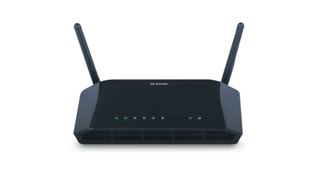

If that doesn't work try restarting your router and/or modem. This fixed my problem.
In case you don't know what they are...
Router:
Modem:
