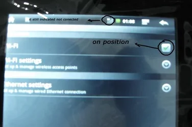

i have the same problem..maybe anyone can help me.
i have 10" android 1.5 with WIFI (Marvel8686,SDIO,802,11G; 3G moudule evdo,tdsdcdma,wcdma), I've Positioned the wifi on, but it's still not working or to be connected.
please look this picture..every time i tried, there are has some notification like that this..anyone can help me...what is the meaning...please help me. thank you
Dear Dewa,
The symbol you've circled isn't wifi at all. It's the symbol for G3, which the tablet doesn't have. You need to go to wifi settings,
and it will tell you which networks are available - then connect. Once you're connected there will be another symbol next to the
G3. It sort of looks like an ice cream cone.
Best,
Will
