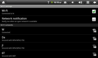

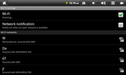

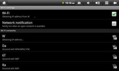

Observation of my 11.2.18 tablet running the stock versions of these files all weekend showed none of the issues you have described. The tablet moved swiftly from Scanning, to Connecting, to Obtaining IP from a WEP enabled Wireless N router.
The issues you have described seem deeper than just these three files, therefore I doubt further investigation will result in a solution. It must have to do with the combination of u-boot-nand.bin, ramdisk.img, Kernel, and system.img that Disgo has utilized to update the tablets to 2.2.
