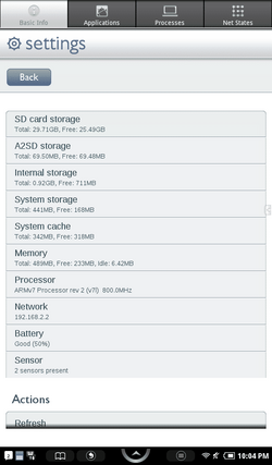

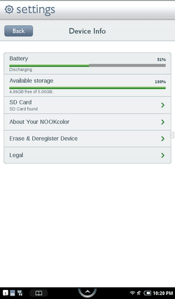

I'm running 1.1 rooted with 3.0 auto-nooter with a 32gb sd card,
everything seems to be working - but I seem to have lost some internal memory-
did not know if there was something I missed or what ?-
can someone check their setting aginst mine and let me know?
thanks
You didn't loose any internal storage and what you are displaying is correct. The first picture shows the total amount, 5 gb which is 8 gb minus the 3 gb hidden partition for the stock recovery. The second picture is not showing all the internal storage and shows how some of it is dedicated. Of the 5 gb total, you have 1 gb dedicated to installed apps, and rest for the android system itself and usable space for you.
