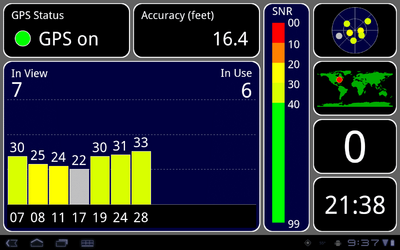

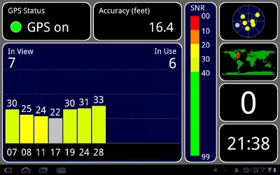

For example- last night I cold started my A500 in my house- within the first min it was viewing 6-8 sats. It took about 2 min to get a good fix. Within 3 min it was using 6-7 sats with 8-9 in view.
After that- I cleared the GPS cache with "GPS Status & Toolbox" https://market.android.com/details?id=com.eclipsim.gpsstatus2&feature=search_result then shut down A500 and rebooted. Once rebooted, it took 3 min or so to even see 1-2 sats, finally got a 3rd sat after a while- then got my first location fix after about 5 min from cold start. And that's even with wifi assist. Went downstairs to let the dog out and do some other things- came back upstairs and looked at the A500- it had now found 8-9 sats and was using 8 sats consistently from indoors. Total time from cold start was about 15 min at this point.
Once again turned off the A500, rebooted- went into "GPS Test" app and had a initial fix in about 60 seconds (because the sat info had been cached from my previous session).
EDIT- Added Screen capture from indoors...
