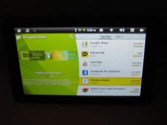

Market working on a SYNET7LP with DG2.20
Currently, the HDPI version of the 2.2 gapps install but require replacement of the existing framework application along with making some permission and property changes. Also, the Market only displays Free applications. This may be an issue with the Location service, settings or something else.

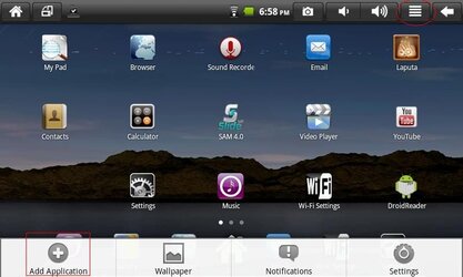

To add Gmail to the main application menu follow these steps:
From the main app window -
• Touch the Menu icon in the top-right of the screen (represented by four horizontal lines) or Press the Menu button on the back of the tablet
• Touch the ‘Add Application’ icon on the bottom left

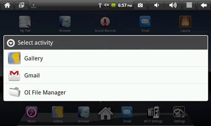

• Under Select Activity, select ‘Gmail’ and select.
The Gmail icon will now appear on the main screen.
