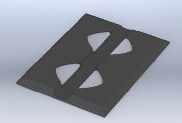

Thought I'd also share my MicroSD card holder/wallet thingermabob.. It'll hold 4 cards, and when they're inserted, they'll lock each other in place. The light grey things are just place holders to keep the holes from collapsing during printing.. The real cards will go all the way to the middle and have a 0.068" gap between them. So, if you have all 4 in, you can't lose one. The holder will be made of rubber, so you just flex it in the middle to remove a card. This item is printing as I type this.. Gnarly!
The intent of this design is that it will fit in the pocket of my Nook case without making a big lump. This item is 0.100" thick overall, so it's barely thicker than a standard SD card (0.085")

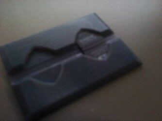

The model is printed and it works perfectly. Here is a super extra blurry cell pic of it holding two cards. They're the furry looking black blurs at the top. Yeah, I'll take a better pic of it when I get to my Rebel.. The cards actually touch each other, which isn't what I'd planned but it works to keep them firmly locked in place. I ended up making it out of a harder plastic and using a living hinge in the middle of it. On the next revision, I'm going to emboss 1, 2, 3, and 4 on each slot, so you can keep track of which card is which.
