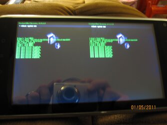

Well guys, I went through the motions just to see if I got different results than the OP. That would be no! I ported clockworkmod recovery from the cyanogenmod source and ended up with the same double screen results that have already been accomplished (see pic).
So clearly the next step is to compile a custom kernel. I have been slowly working on the kernel but now that I see there is no hope for the recovery as is, I will step it up.

If you look in the log in the cache catalog for the recovery, you'll see that its complaining about missing framebuffer support.
Still trying to get the 2.6.32 kernel running, but its not easy, not having any console output for the device during boot.
If we had an rs232 connection or similar to the hardware on the tablet, this would be much easier...

Since I've got recovery "working" now, for me the next step is to get the 2.6.32+ (froyo) kernel running, as the frambuffer debugging just messed up everything even more.The best result i had with the released kernel source, did remove the duplication, but it "skipped" in the menu, so you only saw every 2nd step, which made it even more impossible to use the recovery.
So my focus is now to get 2.6.32 running, and I think I'm making progress, though, its difficult without a screen console / debug as I said before, all kernel panics, or other errors are left in the dark atm.
But if someone can make it work for 2.6.29 nothing is better, though we will still be stuck at eclair, as froyo depends on 2.6.32 or higher.

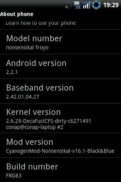

My froyo rom for the droid eris...
Sent from my nonsensikal froyo
You need a few patches on .29 to be able to run froyo but yes it is possible!
