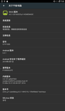

fusm
Jun 5, 2014
58
8
Here is my old p1000, with Marshmallow running on 3.0.1 kernel.
