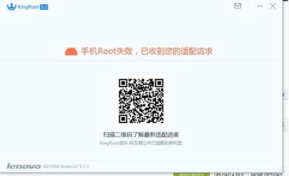

Is this rootable? Because I just got it and if not I'm going to downgrade to the 4.4 rom. But I can't downgrade to the 4.4 rom because its not rootable.

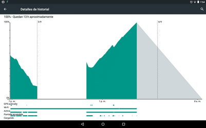

I installed AOSP yesterday (clean install) but I have 2 issues (I really don't know if both are bugs):
- Can't take screenshots
- When I plug the charger it doesn't detect that its charging (The charging icon don't appear and doesnt vibrate or sound or anything and in the battery option doesnt detect that is charging, or other apps). Look at the battery graphic... never detected it was charging, but it was...
Also took me hours to fully charge the tablet (like16 and I have to activate the battery saving mode, but still.). I don't know... could be my charger... Using CurrentWidget I get values (lowest brightness) between -1000mA (!) and -750mA only using browser, -550mA and - 350mA whit the screen on but no use, 0 and -380 screen off without charging. When charging (original charger, but a bit old) I get around +425mA with battery saver mode on and the screen off. I used a low quiality 2A charger and it was almost the same. I don't know whats going on with that.
Anyways! Thankyou! It's much faster!
Ehmmmm.... Well, that's weird??? I don't remember any such problem. Then again, I haven't tried AOSP in a long time. Can't help you right now...
