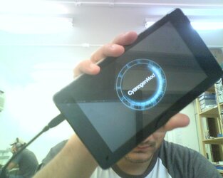

I can install the rom, but it never boot! Still in bootloop for ever!
I can't access tablet thought adb while is in bootloop. With some older versions of cm10 of Asturel I can acess the tablet thought adb.
Here a photo of what is happening... =/
Thanks Guys!

No results. Still in bootloop. Every 5 seconds the tablet make a "tuc" very short and low from speakers.
Even running adb logcat while device is booting is useless.

BOOT LOOP :(
adb locgat still waiting for device... Still making "TUC" from speakers every 5 seconds.
CyanogenMod splash boot in running here, but have 5 mins and still in loop.
What more I can do with this? I CAN'T USE ANDROID 2.2.2... Help meeee hhahahah
