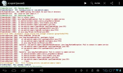

very snappy on v5 but camera is not opening. It says "unfortunately, camera has stopped".. So I flashed v4 rom and camera is working. back to v5 and when starting camera reading logfile
error opening /dev/video: No such file or directory
here is screen shot
