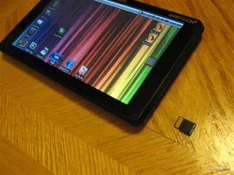

I have to admit (Dumm ...!!! :confused:) , it was all my fault, turns out that I was trying to insert the micro SD card up side down (W/metallic parts facing down) which turns to be wrong, and it should be inserted w/metallic parts facing up (see image)
Thanks to this link "augengentouch78.webs.com"
Finally I can enjoy my new Toy now with all the mods and the updates

There is a small picture on the back of the device that shows you how to insert the mini sd card with the notch towards the bottom of the unit. It is hard to see without good light. I use the stylus to insert the card all the way once I place it in the slot. I also use the stlus to eject the card after I un-mount it. You can use the stylus as a lever against the side of the GT and catch the raised side of the card to remove all the way.
