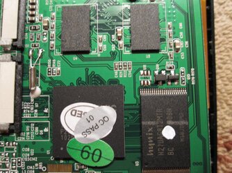

There is (or was, that one went back to DG) a captive ball tilt sensor on my CVS EX7. It is located next to the ribbon connector. (silver cylinder). See pic below.
I would like to see charging by usb if possible. I will have to look at the schematics again to see how they set up the charging loop, but to the best of my feeble old mind, it was there....
