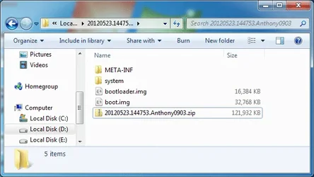

Finally I managed to fix my camera too
The problem was caused by a missing bootloader.img from :9042 - Download - 4shared - kahrloz paz
If anyone have the same problem :
Take out META-INF from 9042 - Download - 4shared - kahrloz paz (Build Number : 20120828.130802)
And system, boot.img, bootloader.img from Anthony0903, original post (Build Number : 20120523.144753)
Then pack them all into a zip file and install it through CWM :
This method worked for me, I don't take any responsibility if it brick your tablet, so be careful!
<img src="http://www.androidtablets.net/forum/attachment.php?attachmentid=11977"/>
Something doesn't sound right, the META-INF used here is from my mobiz port, I dont remember flashing bootloader.img with it.
The camera problem most likely is in the boot.img just using cat command to install boot.img should work.
But anyway glad you got yours fixed and posted how you done it should help others.

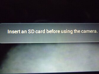

Hello, I have almost same problem, like 5arid...
I got this tablet, and it was bricked by someone else...
I repaired boot loop, with livesuit, and then, camera problem...
well, I installed recovery, and flashed a lot of dumps, and now I have camera back....
but.... now it says "no external storage"
it says I need to install a sd card before.....
I know sd card and slot works ok, because I installed dumps from external sd....
any ideas?
thanks

Hello, I received the tablet, in a boot loop, only way I was able to fix, was via livesuit...
sd card is ok, I can read it in recovery mode, I can install dumps, etc via sd...
problem is inside android... if I enable camera, message appears...
if I try to browse files, I can not see SD....
but sd is ok, I can use it via recovery...
thanks

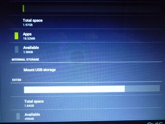

I must have been very, very tired last night. Forgot the KISS principle. Go to settings > storage. You should see 2 headings for internal storage, one for extsd or similar, and one for USB host. Look at extsd. If it says "insert card for mounting", remove it and re-insert it. If it says "Mount SD card" tap that. If it says "unmount sd card" it should be working, but you might try unmounting it and remounting.

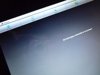

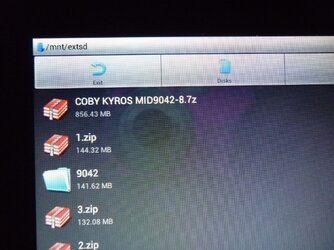

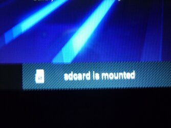

Thanks...
I think, maybe wrong, it's a "PATH" problem...
here some pictures...
as you can see, sd is mounted and detected by system...
if I use ES file explorer, it tries to search at /SDCARD/ but it's empty....
if I try to open gallery, it says "no storage" no external storage available...
if I open ES task manager, and then SD card analyzer it tries to scan /sdcard, and of course, 0 files...
but... here the interesting part....
if I select "disks" inside ES task manager, I can select /mnt/extsd and I can see all files inside my sd...
so, I think there must be a way to edit sd location... maybe VOLD.fstab or some other file..... :D
thanks for your big help :)

In ES file explorer (or any file manager), "/sdcard/" is the internal memory storage. /mnt/extsd/ is your microSD card. Sounds like your system is having problems mounting its internal storage during boot. Makes actually more sense, as the camera and gallery should work without an external SD. Did you recently install a large app, maybe a game?
