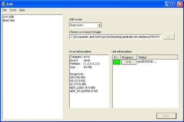

I've done all the steps of for the USB Mode method, the driver loads, the "Dv." turns green, but when I click burn...A word (something japanese or chinese) comes up under the "status" column and it stays at "0%"...then the tablet starts up. I've uninstalled the driver, rebooted, and tried again, and again, nothing...any thoughts

If the files is stored in /data could i just use the burn tool to burn my entire backed up data folder in theory adding the calibration file to where it needs to be?
usagi111
Apr 7, 2011
16
I would say when all else fails... try it after a clean wipe...
Tried it, still didn't work, I don't get it, I'm on hwver 11.2.0.6, I'm using the right file...I don't know what that word is coming up on the 'status'...I'll try to download the ius file again and keep trying.

Okay, I've made a couple of more attempts, I don't know if it's my PC, my USB ports or something, but I took a screen capture of the program when I try to burn...if anyone knows what that word under status means..."failed" or "incomplete" or anything feel free to respond. In the meantime, I'll either look for another PC to try this on, or jus do the Market Hack again and wait...I appreciate any input here.
Can you confirm the "hwver" of the device? An attempt to burn the incorrect *ius is suspected to Fail.
Here are the potential Status messages -
Code:
iuw: Failed to get image description magic.
iuw: Unknown type of image.
iuw: Not a valid infoTM wrap! Magic do not match.
iuw: Not a valid infoTM wrap! Hcrc do not match.
iuw: Hcrc passed!!
iuw: Image type %d is not supported currently.
iuw: Not a wrap for the current board.!
iuw: 0x%08x <==> save: 0x%08x, len=0x%x
iuw: Not a valid infoTM wrap! Dcrc do not match.
iuw: Dcrc passed.
iuw: Not a valid infoTM wrap! Image count out of baundry.
iuw: Get image %d faild, maybe the update wrap is demaged.
